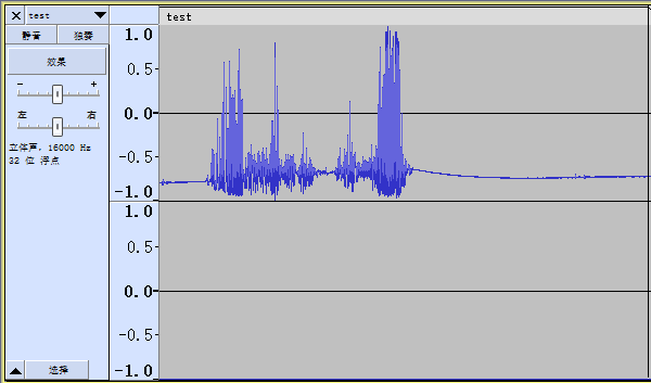

  • Have you tried to use the echo test command first to determine whether it works properly?
    ffmpeg -f alsa -i default -f alsa default
    tried to execute the record audio command you provided, using Audacity is able to see the waveform
    arecord -f S16_LE -c 2 -r 16000 -D hw:0 -d 30 test.wav
    The system default mixer control settings can be recorded, you can refer to it
