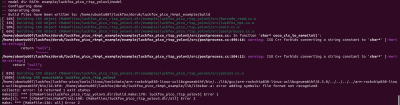

  • I have observed that your process does not seem to have configured a cross compilation environment for the zbar library. From the error message 'file format not recognized', I think this is a high possibility.

  • Yes, you are right. That's why I am trying to implement the ZBar Barcode Reader. However, I am facing some problems. I added the code to the main.cc, but I couldn't compile ZBar for arm-rockchip830-linux-uclibcgnueabihf. Can you help me?

  • Yes, you are right. That's why I am trying to implement the ZBar Barcode Reader(https://github.com/mchehab/zbar). However, I am facing some problems. I added the code to the main.cc, but I couldn't compile ZBar for arm-rockchip830-linux-uclibcgnueabihf. Can you help me? Or can you suggest a different method to read the QR code?
  • We have not tested the Zbar library yet, but you can refer to the following link:https://zhuanlan.zhihu.com/p/673575607
