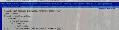

cat sysdrv/source/buildroot/buildroot-2023.02.6/.config | grep "RKISP"
BR2_PACKAGE_LIBCAMERA_PIPELINE_RKISP1=y

If this is not the proper way to enable the camera, then what is? The only thing which mentions rkisp in buildroot is related to a LIBCAMERA pipeline. @Crocodile Your message is confusing.
