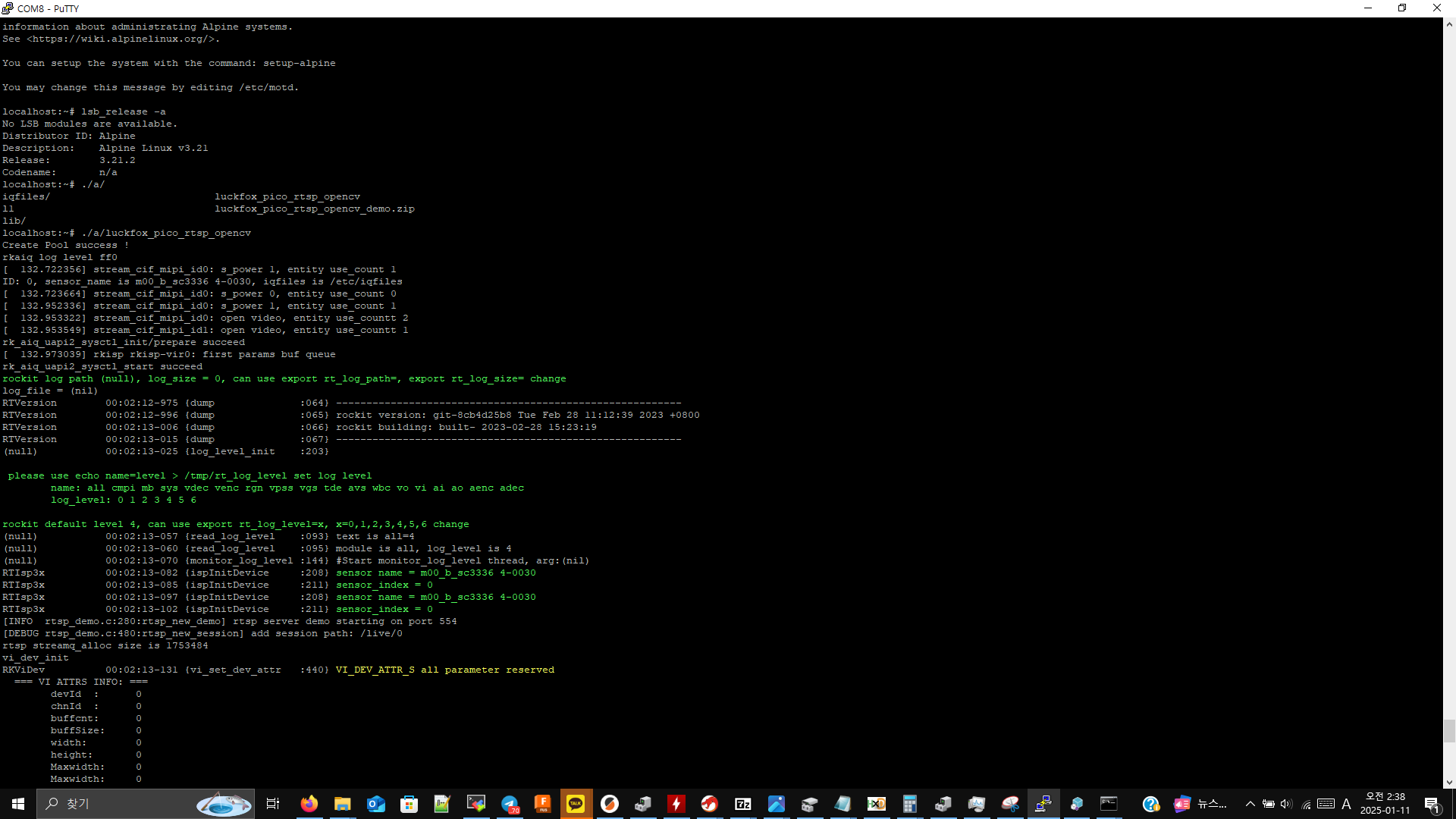

Hello. Please help me.
I'm trying to do everything according to your "recipe" from GitHub. But when executing the command "apk --root alpine add $(cat packages)" 4 errors occur. I'm attaching the view from the terminal.
