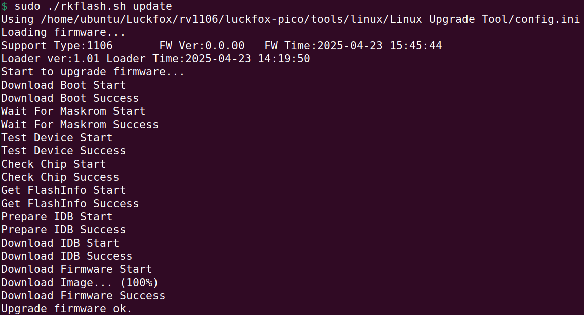

    I've tested the burning process on my end, and everything worked normally. I wasn't able to reproduce your issue. Could you please try replacing the download data cable? Additionally, you can refer to the successful download log I've provided to check for any error messages. Identify the relevant issues based on the errors. During the flashing process, you might experience brief USB disconnections/reconnections, which is normal.

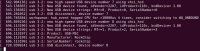

    sudo dmesg | tail -n 50
  • Thank you for your reply. I changed the cable (the one provided with the device) and I was able to flash it once. But only once! Now the segmentation error message occurs every time I try to update the device, using the same cable!
    What can I do? This seems very unreliable. Is this the case for all devices?
    I've noticed that you loader time is more recent than mine. Yours is 2025-04-23. Might this be an issue?
