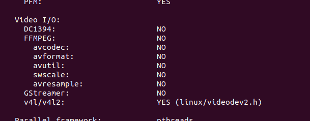

currently I am using the cross-compilation approach, I have cross compiled opencv also for luckfox pico, when i run it on pico it is not able to read due to lack of ffmpeg, I am trying to cross compile opencv with ffmpeg but it is happenning, am i doing something wrong
cmake ../opencv \
-DCMAKE_TOOLCHAIN_FILE=../luckfox.toolchain.cmake \
-DCMAKE_BUILD_TYPE=Release \
-DCMAKE_INSTALL_PREFIX=install \
-DOPENCV_EXTRA_MODULES_PATH=../opencv_contrib/modules \
-DWITH_FFMPEG=ON \
-DWITH_V4L=ON \
-DCMAKE_PREFIX_PATH=/home/docketrun/Downloads/test1/ffmpeg-build \
-DCMAKE_LIBRARY_PATH=/home/docketrun/Downloads/test1/ffmpeg-build/lib \
-DCMAKE_INCLUDE_PATH=/home/docketrun/Downloads/test1/ffmpeg-build/include \
-DBUILD_TESTS=OFF \
-DBUILD_PERF_TESTS=OFF \
-DBUILD_opencv_python=OFF
-DFFMPEG_INCLUDE_DIRS=/home/docketrun/Downloads/test1/ffmpeg-build/include
-DFFMPEG_LIBRARIES="/full/path/to/libavcodec.so;/full/path/to/libavformat.so;/full/path/to/libavutil.so;/full/path/to/libswscale.so"
output ==== pls find in attachment.
====== any documentation on how to cross compile opencv with full support or cross-compiled opencv which i can download.

Regarding the compilation issues on OpenCV and the software dependency problems during the running process, it is recommended that you seek help from the OpenCV community. I have no relevant usage experience.
