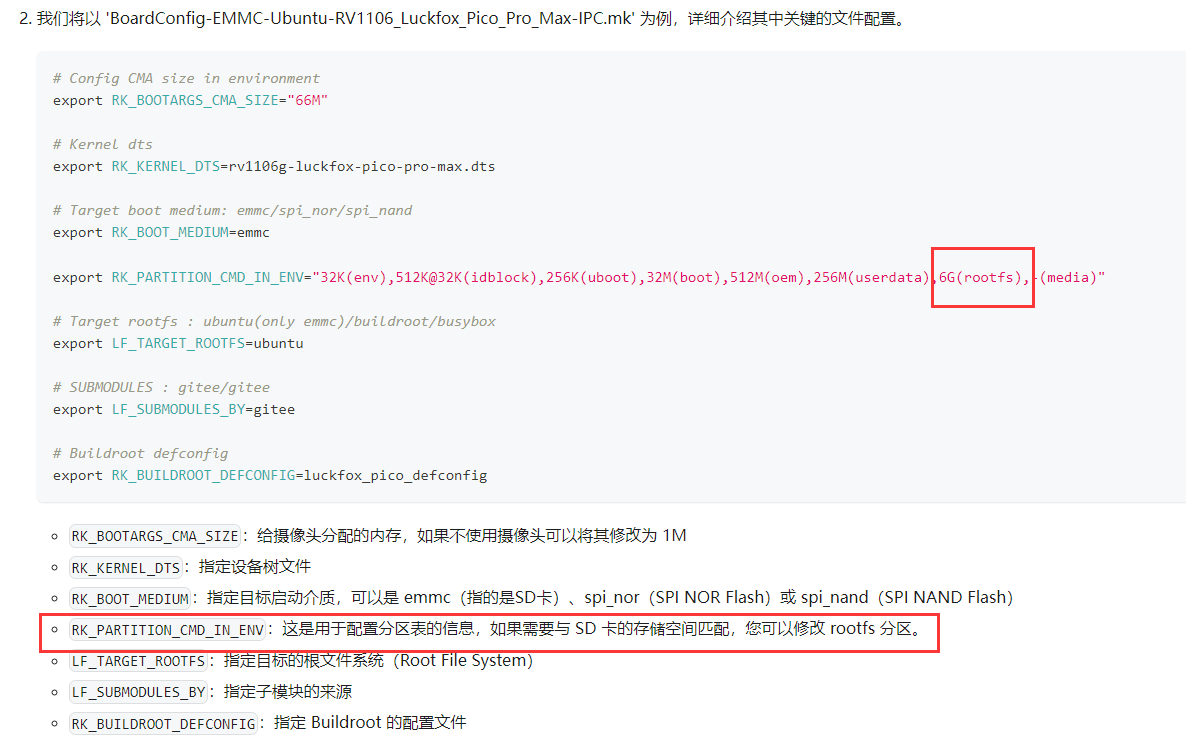

LuckFox Pico Max烧录系统Luckfox_Pico_Pro_Max_Ubuntu,使用SD卡启动,SD卡中未挂载的分区如何挂载?
df -h
Filesystem Size Used Avail Use% Mounted on
/dev/root 5.9G 2.2G 3.5G 39% /
tmpfs 91M 0 91M 0% /dev/shm
tmpfs 37M 688K 36M 2% /run
tmpfs 5.0M 4.0K 5.0M 1% /run/lock
/dev/mmcblk1p5 488M 26M 456M 6% /oem
/dev/mmcblk1p6 240M 2.1M 233M 1% /userdata
tmpfs 19M 0 19M 0% /run/user/1000
lsblk
NAME MAJ:MIN RM SIZE RO TYPE MOUNTPOINTS
mmcblk1 179:0 0 58.2G 0 disk
|-mmcblk1p1 179:1 0 32K 0 part
|-mmcblk1p2 179:2 0 512K 0 part
|-mmcblk1p3 179:3 0 256K 0 part
|-mmcblk1p4 179:4 0 32M 0 part
|-mmcblk1p5 179:5 0 512M 0 part /oem
|-mmcblk1p6 179:6 0 256M 0 part /userdata
|-mmcblk1p7 179:7 0 6G 0 part /
`-mmcblk1p8 179:8 0 51.5G 0 part
sudo lvmdiskscan -v
/dev/ram0 [ 4.00 MiB]
/dev/mmcblk1 [ 58.24 GiB]
/dev/ram1 [ 4.00 MiB]
/dev/ram2 [ 4.00 MiB]
/dev/ram3 [ 4.00 MiB]
/dev/ram4 [ 4.00 MiB]
/dev/mmcblk1p4 [ 32.00 MiB]
/dev/ram5 [ 4.00 MiB]
/dev/mmcblk1p5 [ 512.00 MiB]
/dev/ram6 [ 4.00 MiB]
/dev/mmcblk1p6 [ 256.00 MiB]
/dev/ram7 [ 4.00 MiB]
/dev/mmcblk1p7 [ 6.00 GiB]
/dev/ram8 [ 4.00 MiB]
/dev/mmcblk1p8 [ <51.46 GiB]
/dev/ram9 [ 4.00 MiB]
/dev/ram10 [ 4.00 MiB]
/dev/ram11 [ 4.00 MiB]
/dev/ram12 [ 4.00 MiB]
/dev/ram13 [ 4.00 MiB]
/dev/ram14 [ 4.00 MiB]
/dev/ram15 [ 4.00 MiB]
0 disks
22 partitions
0 LVM physical volume whole disks
0 LVM physical volumes
要调整SD卡未使用的分区,目前只能在SDK配置中进行。请参考以下教程:https://wiki.luckfox.com/zh/Luckfox-Pic ... x-Pico-SDK
