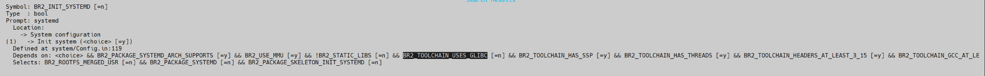

Unfortunately, bootchat relies on glibc, and as rv1106 currently does not support glibc, the use of bootchat is not possible at the moment. I hope you can find alternative methods for implementation and look forward to any insights you might share in the future.

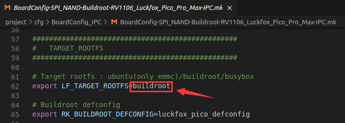

Hello, it is recommended to optimize the loading time of the kernel and rootfs through the following two points:
1. Streamline the kernel configuration to remove unnecessary features and drivers. Use make menuconfig to select only the components you truly need. This helps reduce the kernel size and improve loading speed.
2. Configure LF_TARGET_ROOTFS to use BusyBox, enhancing the system startup speed.
