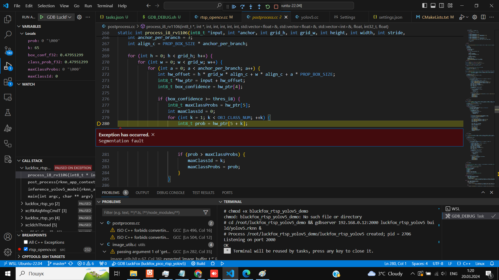

I then converted yolov5s.onnx using the convert.py script "rknn_model_zoo\examples\yolov5\python" to yolov5.rknn. But when running the model on RV1106 I get an error for some reason.

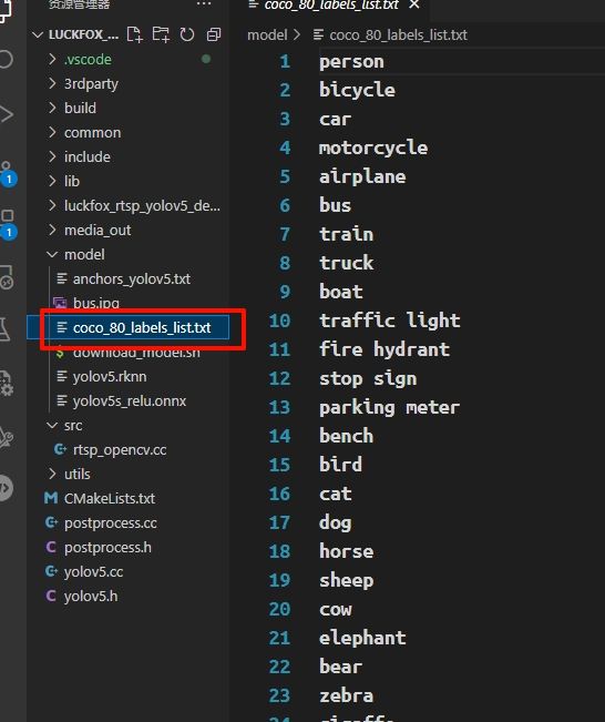

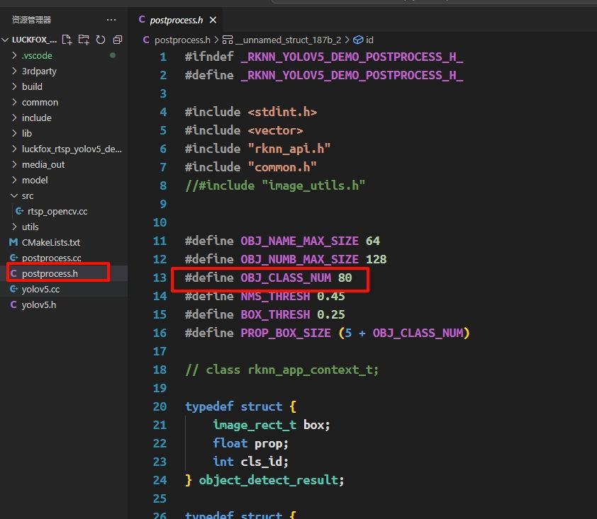

The trained models may vary in the number of categories and their structures. Parameters need to be adjusted at runtime. You need to set the OBJ_CLASS_NUM parameter in the postprocess.h file and modify the coco_80_labels_list file in the model folder to change the names of the categories.
