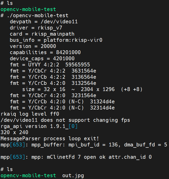

您好:
我在运行
1. opencv-mobile:
https://wiki.luckfox.com/zh/Luckfox-Pic ... ncv-mobile
时遇到报错:
this device is not whitelisted for jpeg decoder cvi
this device is not whitelisted for capture cvi
devpath = /dev/video11
driver = rkisp_v7
card = rkisp_mainpath
bus_info = platform:rkisp-vir0
version = 20000
capabilities = 84201000
device_caps = 4201000
fmt = UYVY 4:2:2 59565955
fmt = Y/CbCr 4:2:2 3631564e
fmt = Y/CrCb 4:2:2 3136564e
fmt = Y/CrCb 4:2:0 3132564e
size = 32 x 16 ~ 2304 x 1296 (+8 +8)
fmt = Y/CbCr 4:2:0 3231564e
fmt = Y/CrCb 4:2:0 (N-C) 31324d4e
fmt = Y/CbCr 4:2:0 (N-C) 32314d4e
rkaiq log level ff0
/dev/video11 does not support changing fps
rga_api version 1.9.1_[0]
320 x 240
MessageParser process loop exit!
mpp[512]: mpp_buffer: mpi_buf_id = 136, dma_buf_fd = 5
mpp[512]: mpp: mClinetFd 7 open ok attr.chan_id 0
设备为pico_plus
我在运行
1. opencv-mobile:
时遇到报错:
driver = rkisp_v7
version = 20000
rkaiq log level ff0
320 x 240
设备为pico_plus

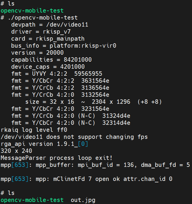

这是在使用 pico plus 的 buildroot 镜像运行的结果,但无法复现你提到的错误
