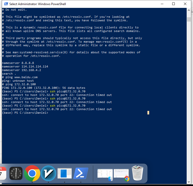

Turn off the computer firewall; it is likely that the firewall on your computer is blocking ICMP (ping) requests.danielclover wrote: ↑2024-07-07 10:04 Hi Taylor, i was facing the same issue. can't usb over network.
