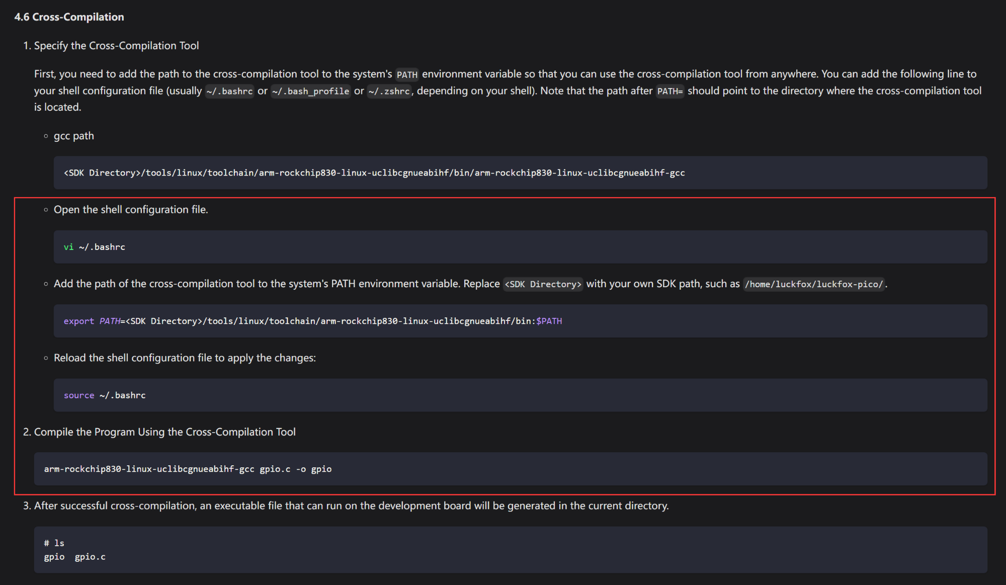

    I believe I have all the build tools installed correctly on my Docker image, but when I try to run the above command, I get:
    arm-rockchip830-linux-uclibcgnueabihf-gcc: command not found
    Thanks!
  • torchris4 wrote: 2024-01-29 20:37 I'd also like to have a minimal 'helloWorld.c" example to work from.
    Thanks!
    You need to add the path to your cross-compilation tools to your system's PATH environment variable:
    https://wiki.luckfox.com/Luckfox-Pico/L ... -c-program

  • Thanks! Fixing the PATH up worked! There's a lot of steps to work through! :D
