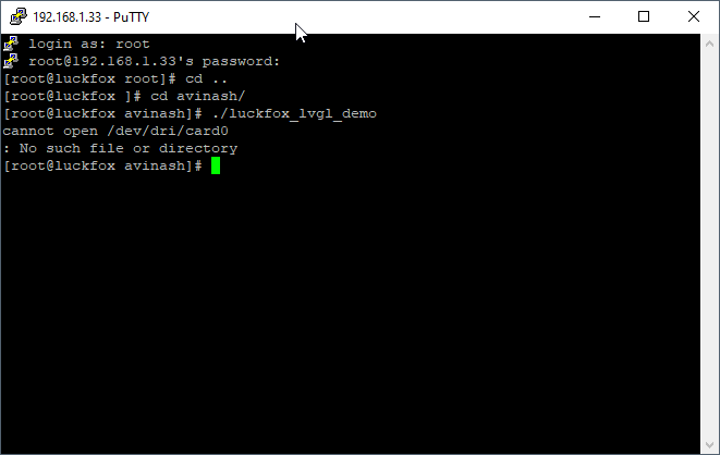

When I try to run the lvgl (Graphic Lib) demo, I get the following error.
cannot open /dev/dri/card0
: No such file or directory

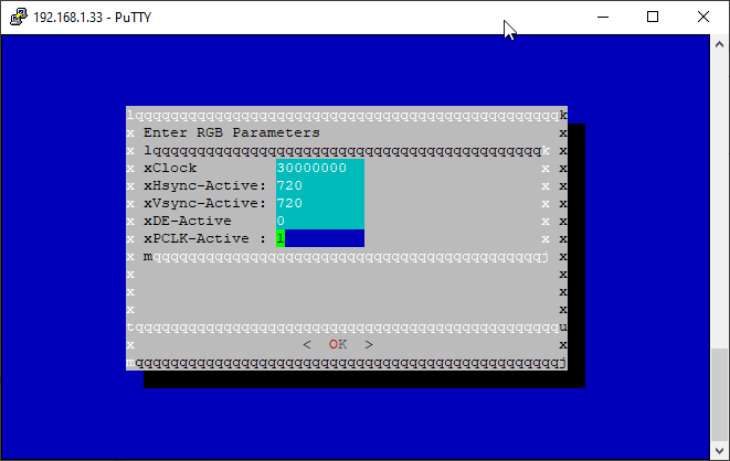

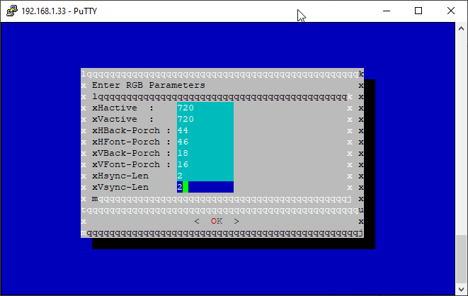

I ran luckfox-config command and then enabled RGB and Touch Peripherals. In RGB peripheral I put panel configuration parameters and timming parameters from the Wiki device tree settings.

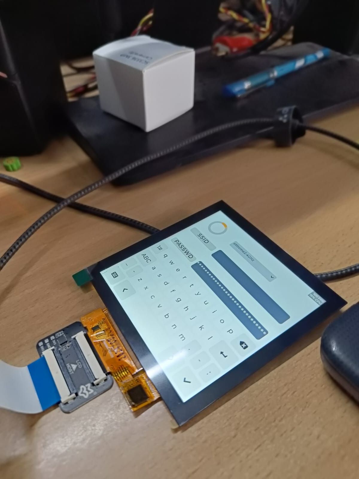

After restarting the board, the entry for DRI was created /dev/dri in rootfs. Then I ran the LVGL demo and woo! It ran successfully.
