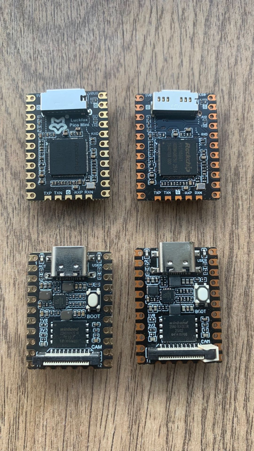

    By the way, have ordered a batch of Pico Mini. Some of them have fox logo and label near SD card slot, but some have not. Other is mostly the same. This is first batch without logo or oem? This is your manufacture or others? Different dates/pcba or have any schematics version/difference?
  • We would like to clarify that we have never produced Luckfox Pico Mini boards without our official logo. The board shown on the right appears to be an unauthorized copy, manufactured using a lower-cost negative process with unverified component sourcing.
    If possible, would you be willing to provide the purchase link? Your assistance would be invaluable in helping us safeguard our brand and protect customers from substandard products. Thank you very much for your understanding and cooperation."
