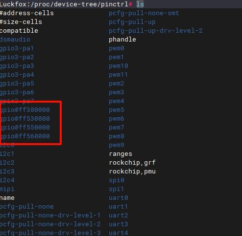

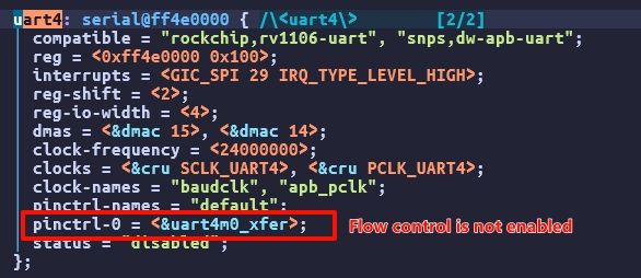

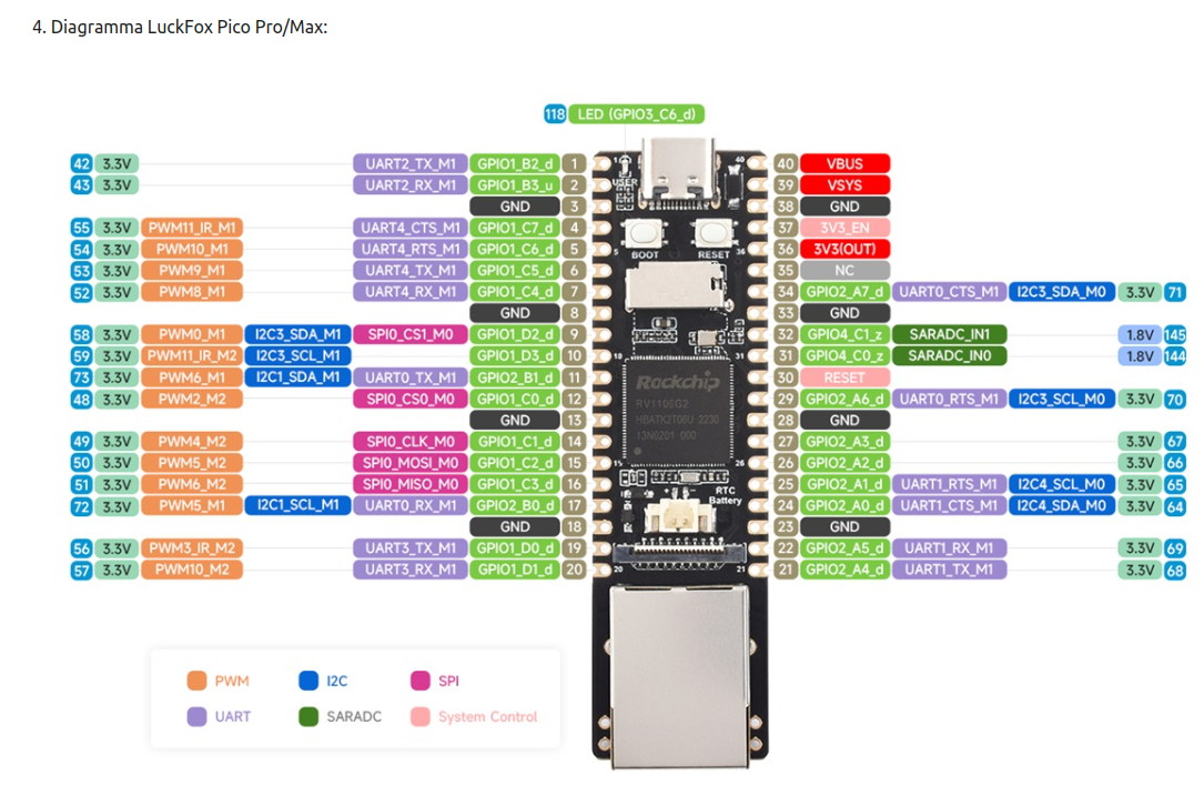

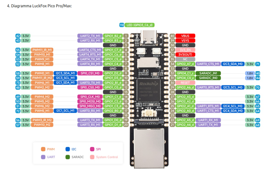

    I have previously tested it in buildroot and ubuntu environments, and it can be controlled normally when the device tree is set up properly. Alpine Linux is provided by the community and we do not maintain it. I have tested and found that most of the GPIOs are reused. The pins provided on the luckfox-pico pro are reused for functions such as UART SPI IIC PWM except for UART4's flow control pin (54 55) which is not used.

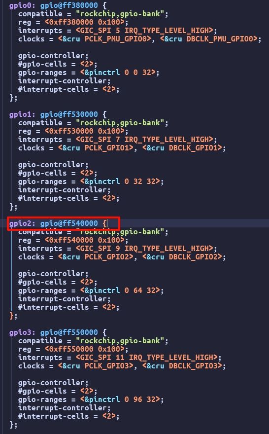

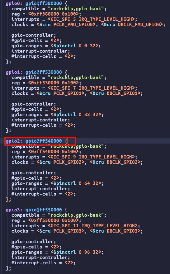

    It would be ideal to use pin 66 67, but I found in /proc/device-tree/pinctrl that gpiochip2 is not enabled (pins 64 through 95) and therefore cannot be controlled
    Alpine Linux's original image may not be suitable for your use case, You need to reference [url] https://wiki.luckfox.com/Luckfox-Pico/L ... e-Linux-2/ [/ url] modify the device tree to liberate more pins.

    Alpine Linux adaptation is provided by community members. In the https://wiki.luckfox.com/Luckfox-Pico/L ... e-Linux-2/, it mentions building rootfs.img and modifying the contents of build.sh. As for the device tree and drivers, the boot.img is built using Luckfox SDK. Therefore, you can customize your desired peripheral configuration by replacing boot.img during the burning phase.
    The boot.img in the luckfox-pico pro max image on the cloud drive has been tested and can control gpiochip2 (64 ~ 95).

  • I have the same problem. Also checked, and realized that there is a few more pins that can be used. I checked only outputs (not inputs!) and stability of high/low values. Is there any way to disable SPI, I2C or UART programatically and free more pins in Alpine Linux?
    These pins might be used as output in Alpine:
    gpio4
    gpio34
    gpio54
    gpio55
    gpio97
    gpio98
    gpio99
    gpio100
    gpio101
    gpio102
    gpio103
  • Alpine only replaces the root filesystem. If you need to configure external devices, you can modify the device tree in the traditional way, compile it, and generate a new boot.img. You can then flash the boot.img separately.
