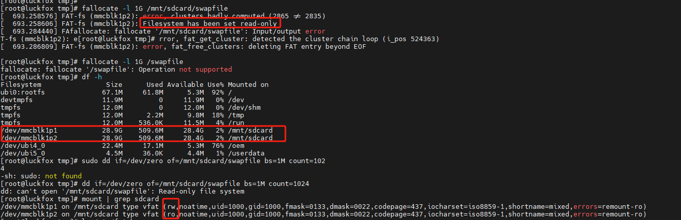

    Create a swap file using the method you provided, but encountered some errors.
    The SD card has two partitions mounted to the same directory, but the permissions of the two partitions are different.
  • Your SD card appears to have multiple partitions, and the mount permissions may not be set correctly. You can try using
    umount /dev/mmcblk1p2
    to unmount the unused read-only partition or use
    mount -o remount,rw /mnt/sdcard
    to remount the partition with read-write permissions.
  • Crocodile wrote: 2024-08-20 1:12 Your SD card appears to have multiple partitions, and the mount permissions may not be set correctly. You can try using
